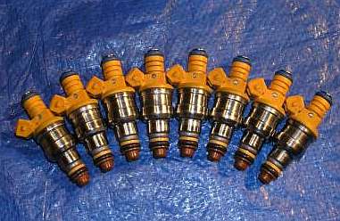

Yes for the most part. All the ford injectors that look like ours will fit. Come to think about it damn near all of them will work. Might wanna go with 24s or even some 3.4 dohcs are like 30ish. That way the injectors aren't running close to max and you have room for more fuel if needed down the road.

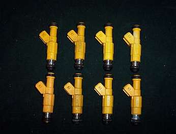

I just installed 19's in my car, turbo'd 2.8, and It's running pig rich but they do fit. I attribute the problem to the chip that is in it and am working towards gathering the information to send to Darth to get a custom chip made. I bought the design two injectors like this.
I also bought the design three injectors, but they are too short and don't have the groove for the clips so stay away from these.
