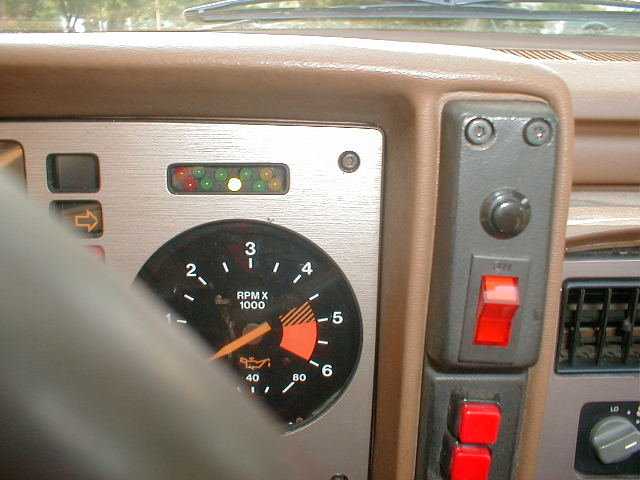

86 2M4 stock 2.5L 4 cylinder w/ automatic
O2 sensor does the normal rich/lean readings as a response to computer control of the injector.
A/F gauge
If the car idles at a stoplight, the sensor readings slowly go lean to very lean, rpms drop & engine will die.
Also after cruising for about 80 miles at 60-65 mph, the sensor goes lean when going up grades or slight increases in elevations. It will stay lean long enough to trigger the SES light with code 44. I can either floor the gas or hold the cruise switch over to the right, causing the engine to go rich. This will turn off the SES light and the O2 sensor resumes the normal rich/lean reading until the next rise.
During the next rise when the sensor goes lean and before the SES light is triggered again, I can decrease the cruise speed 1mph by momentarly pressing the cruise button in the end of the stalk. This causes the O2 sensor to temporarly resume it's normal readings.
If the A/C is on, it makes the engine more sensitive to load increases such as hills.
Lastly, coming into a 30 mph zone, I let the car coast down. This also causes a very lean situation triggering the SES light. Boot the gas to turn off the light and O2 goes back to normal readings.
Question: Is this an O2 sensor problem? or A computer problem? or Something else?

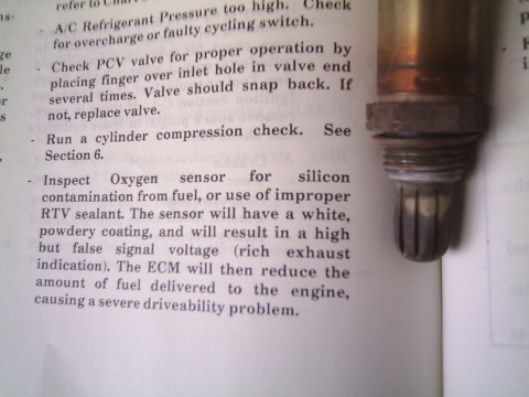

Report this Post08-06-2006 05:28 PM Click Here to See the Profile for 30+mpgSend a Private Message to 30+mpgDirect Link to This Post
Might this be the problem?
Any RTV I've used on the engine reads "Oxygen sensor safe" on the squeeze tube.
I'll swap it for a good one and see if the problem goes away.
Any way to clean the O2 sensor?

Yes, but you need to replace it. It can technically be cleaned but no one can afford the cost or process.

The only places I use RTV on a 2.5L are oil pan, timing cover, water pump, valve cover, lifter cover & themostat base.
