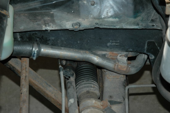

I have removed coolant pipes from two cars, one with a 2.5 and the other with a 2.8, I didn't have to remove the front cross member, it is a pain though and you will need room on the sides to move the pipe around to get it to come out.
There is one hard to get at screw with a 10mm head that bolts the front flange on the coolant tubes to the cross member, remove the hoses at the ends, the two under car clamps and the two screws, you will find it easier to do with the front wheel liner out also, I belive I even removed the spare tire tub under the front declklid.
Here's a pic of the passenger side pipe at the front with the spare tire tub removed and it shows the tab with the screw that you have to remove.
The coolant pipes are stainlees steel.
I had one that was dented in the front on the 2.8 and it was causing it to run hot, I ended up getting another pipe that was dented at the rear, I did a cut and paste and had a friend Tig weld the two halves together, worked great and solved the running hot problem.
