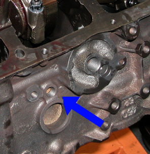

You can get an oil-water cooler from any 91-93 3.4 DOHC. It will bolt right up to the 2.8. You might have to get creative with the coolant lines (plumb them into the heater system..) or they might work as is, not sure.
The 3.4 DOHC cooler gets its water out of the block here (note the block is upside down in this pic):
If you're lucky your 2.8 will just have a plug there and you can replace it with a hose fitting.
The coolant outlet from the cooler goes directly back to the water pump. If the 2.8 water pump has an extra inlet you could just use that, otherwise you'll have to T into something else.
You can also get a similar cooler on ebay; make sure you ask for it with the 18mm adapter nut:
http://cgi.ebay.com/ebaymotors/XTRA-HD-Water-to-Engine-Oil-Cooler-PH8A-3-4-16-New_W0QQcmdZViewItemQQcategoryZ46095QQihZ019QQitemZ8077051944
