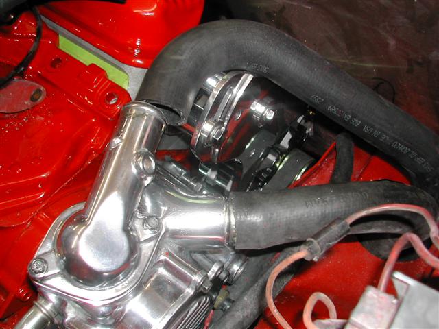

That is a clean lookin lt1. You didn't use the stock water pump as shown in the picture on the stand did you? I didn't think that was possible. What type of exhaust manifolds are those? Have you had any problem with cracking on the exhaust manifold.
Most of the lt1 swaps use the stock water pump..
