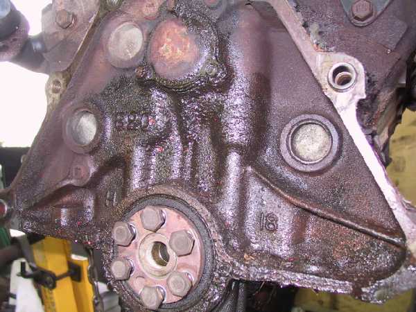

Well, since no one posted a pic I'll do it. Here's a typical cam cover plate leaker. Like stated, the cover plate is the one with three bolts above the crank.
