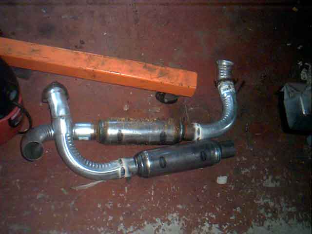

I'm only using a single tip.. this is what my setup looks like:
The overall length of the Spiral Flow is 18", which is the same as my glasspack IIRC, I'll have to get the measuring tape.
no dual? Thats cool but if you use the total length of the spiral then you would probably have to do a 90 degree radius off the exhaust manifold flange off to one end of the availible area then a u raduis then the muffler which would just fine for a single outlet. Of course i like duals it looks sort of funny to me to have the space for it on one side and nothing there ..too bad there isn't a filler panel so it looks like it came with a single stock
