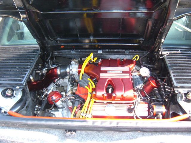

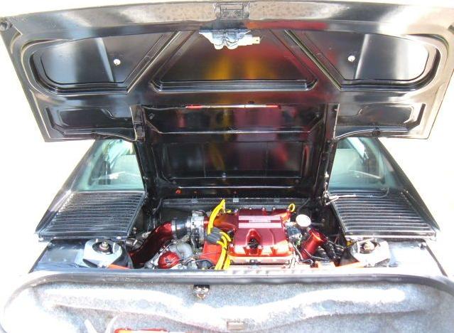

Well, my wife and I got the motor started Sat. overall it went very well !! Took about 5 minutes to get it started and then another 5 min. of adjustments to get it to idle. (timing, fuel pressure and TB adj, screw) Ran it for about 10- 15 min and then drained the oil. and changed the filter. It is running much better than I expected so I took it for a little drive, motor ran good, clutch working,
and no codes.....yet. Overall I am very happy !!!
I have 2 minor issues that I started a seperate thread to discuss. Radiator fan was not coming on and fuel pressure is low.

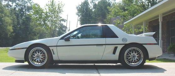

Ok, here it is installed and ready for the car show in Gonzales, Louisiana tonight at the Tanger Mall !!
Hard to tell I know in the pic but I lowered the rear another 1" .
All cleaned up ready to go !!

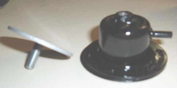

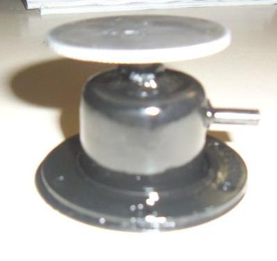

1. I wasn't getting enough fuel pressure. I found the New Holley FPR was defective.
After seeing how it was made I decided to get my money back and make my own.
It is working great, see the pics below.
I just drilled a hole in the top of the cover, brazed a fine thred nut on top
Machined round disk knurled the edge and brazed it to a fine thread stud.
And replaced the internals.
And here you go !!
