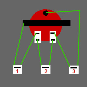

step 1
use high scale should read very high (Infinite) if not replace
step 2
use low scale should read very low or zero if not replace coil
step 3
use high scale should not read infinite if it does replace coil
The steps are out of my chiltons manual.

Toaster_Man
Posts: 552
From: Alton, IL
Registered: Mar 2005
Report this Post03-22-2006 09:26 PM Click Here to See the Profile for Toaster_ManSend a Private Message to Toaster_ManDirect Link to This Post
Thank you very much. Looks like the test couldn't be any simpler.
