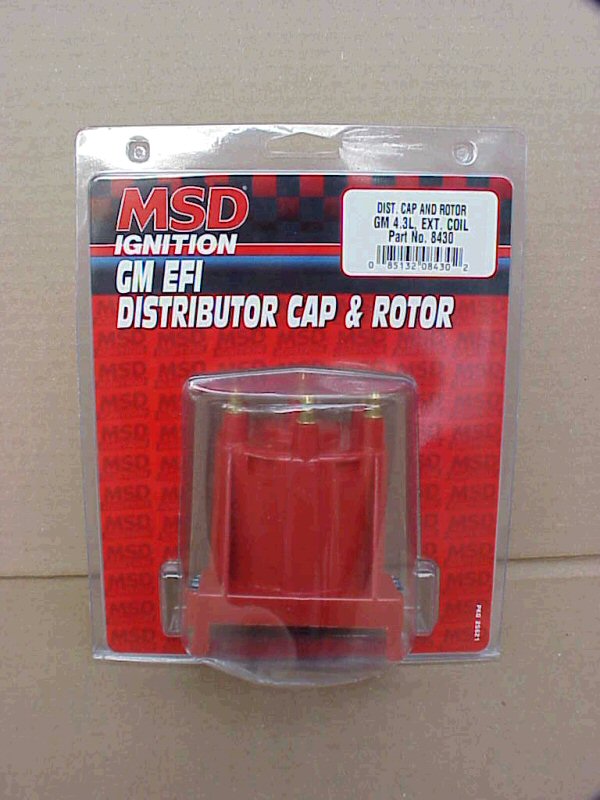

Time to resurrect the RED Distributor caps. Most commonly used are Wells DR2012-G and Conrad DR-2012-G.
The GM 4.3L V6 used in Syclone/Typhoon used a similar distributor. MSD has a cap/rotor that works (pictured below). MSD PN# 8430
It appears that TAYLOR may have one that would fit too "GM 6 cylinder, HEI remote coil - electronic" PN# 918133 kit (cap and rotor)
Website http://www.taylorvertex.com/hp/index.cgi/DistributorCapsRotorsandKits

I have one of these on my Formula now. It works on the 2.8, even though it says it's for the 4.3.
And yes, OEM was gray. But these LOOK more like OEM, since everything else is red.

A crack in the paint acts just like a crack in the cap, when damp or wet it will miss-fire and arc causing a miss firing engine. My next door neighbor did this and it resulted in a light show under the hood.
Auto-zone had the MSD red caps also although they swore up and down that it wouldn't fit the V-6. I had proof that the AC Delco part number #D314A fit the 4.3 and 2.8 along with a whole slew of engines from AC Delco web site.
Now if MSD would make a billet distributor for our V-6 engines!

Autozone has the MSD red cap, they may have to order it, took two days for mine to come in.

Actually, compared to the red Conrad brand cap & rotor (they're sold together by the way) that Autozone used to sell, they're not much different in price. I paid about $25-26 dollars for the Conrad cap&rotor at Autozone before they stopped selling them.
I figure they're more money because A) supply and demand (not very many people care to have red caps) and B) you paying extra for the brass contacts. (as opposed to aluminum)

Checker Auto Parts quoted me $39 and a 3 day wait for the red MSD 8430 set.
Autozone's price is $21 for the same MSD 8430 and only takes 1 day to deliver to the store.
