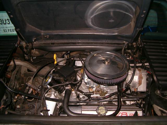

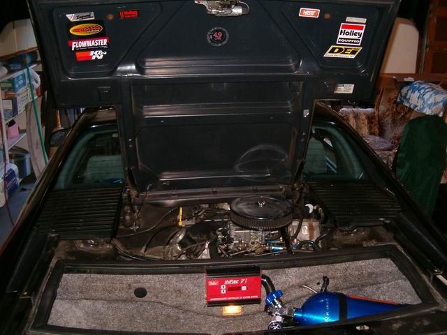

I used a brand new holley 500 cfm carb and put an electric choke, vent baffle, spring loaded needle and seat and dropped the jet size by 2 sizes. It runs very well. I used the stock 4.9 pfi intake manifold with an adapter plate to bolt the carb to. here is a picture when the swap was first completed, before my new ignition or nitrous.
and here is a relatively recent picture, i've cleaned up some wireing and stuff since this so keep that in mind.

Zac88GT,
Thanks for the info. What type of adapter did you use? Did you modify a Holley to TBI type of adapter or is their a "unique" adapter just for this particular application?.

The adapter that i used was actually already made, my old high school shop teacher had one already made for another project but went a different route so he just gave it to me. It's just made from a 3/4" plate of aluminum but i hear a lot of people just make the adapter out of an aluminum carb spacer. The 4.9 is from a 95 and to get the right distributor i had to buy an earlier one with the flat bottom, mine was from an 85 4.1 eldorado i think, and then take the guts from a early pontiac HEI distributor and put them in , they pretty much just drop right in. you just need to cut the shaft to the right length and drill a new hole for the gear pin.

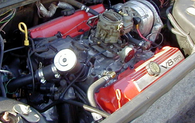

Here's a pic of my setup. Rochester 2 barrel with an adaptor I made.
It is now equipped with an electric choke. The biggest hassel has been
getting the 4T60 tv cable hooked up to work properly.

Nice install you have there. What did you do for the Ignition on your 4.9? Looks like a modified HEI ?

Thanks.
It is a modified HEI. I've done two 4.9s this way. Due to the weather
here in the great frozen north I haven't been able to drive it enough
to fine tune it.
