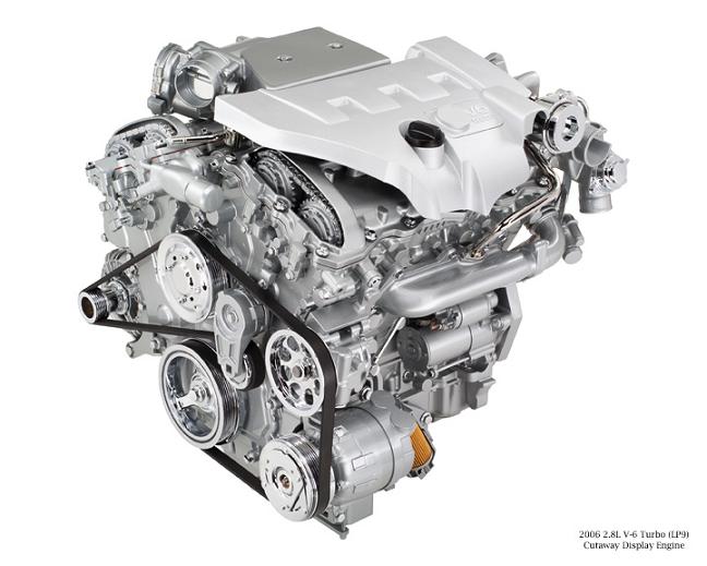

This is the new 2.8 DOHC engine. It is an 06 release.
Link to its specs.. http://media.gm.com/us/powertrain/en/product_services/Spec%20Sheets/HFV6/2006%20HFV6%20(LP9).pdf
See, it is getting the F40 which we know is the M6 pattern.. So, this 2.8 DOHC will be M6...
