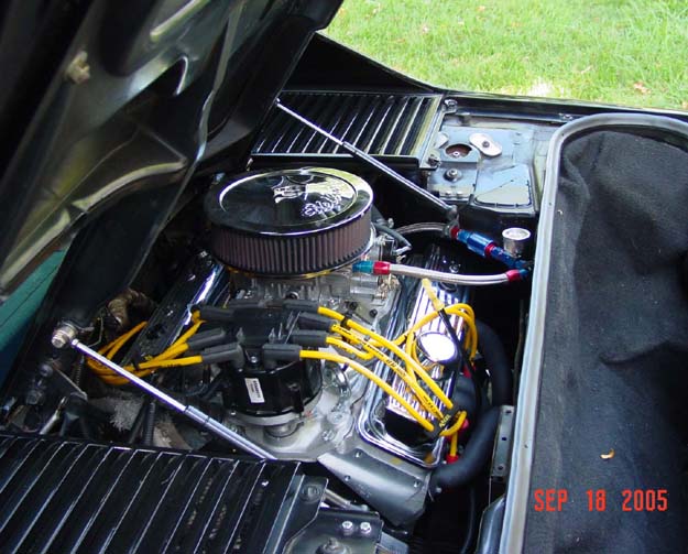

Hey Tim,
What strut tower brace is that on your car?. I've heard opinions that vary or that they don't do "much" because of the design of the car. But I like the looks of them anyway. I'm doing my V8 Swap now.
Thanks Brian

Report this Post04-24-2006 06:37 PM Click Here to See the Profile for TD37Click Here to visit TD37's HomePageSend a Private Message to TD37Direct Link to This Post
3084me, Darrel Morse used to make them. I bought mine when he was clearing out his last batch. As far as I know he has a few for 88's left but I could be wrong. I've heard the same thing about the space frame being rigid enough that a strut tower brace doesn't do much of anything. But I agree with you, I bought it for looks. Here is his SN, morse86@aol.com, send him a PM and see if hes got a few sitting around. I will tell you they are of the highest quality. They are powder coated and very beefily built. You don't use those little oval thingys for the shock tower and his brackets look a ton better. Good luck.
Alex4mula, I remember reading you're thread top to bottom as I started digging into my swap and it is very informative. Very good job of showing the dirty little secrets. Just like you said, no one talks about. Great job!
