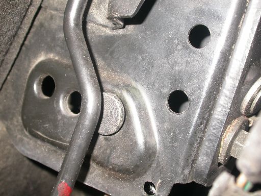

Report this Post04-21-2006 01:04 PM Click Here to See the Profile for Mr.ChippsSend a Private Message to Mr.ChippsDirect Link to This Post
There are three holes in a raised portion of the bracket, it was already in the hole as shown in the photo.
Got out the old ratcheting puller and sucessfully pulled the torsion bar all the way to the back. However the "Nail" would not go in the next hole to the right and up a little from the group of three. Looked in the hole and the torsion bar was totally blocking it.
So my conclusion is that it is allready in the extreme hole.
What next?? Take the torsion bar out and tweak it some so it has more upward force??
Paint the broomstick a matching color to the car??
Go with a litt piston
Any suggestions??

Dude you have the wrong torsion rods probably. Do you have D80 on your option codes? If not your spoiler was probably added later and the non-decklid spoiler springs were not replaced with the spoiler decklid springs. They are color coded but I forget which ones are the heaviest...I believe it is the white one. You used to be able to buy them from GM a few years back but don't know if available anymore.
Well I'm getting smarter every day thanks to this Forum.
My VIN number is 1G2PE11R5HP233575.
It has a Spoiler.
And the torsion bars are RED.
Possibly the torsion bars are wrong.
Anyone Know what color they should be with a spoiler?

From the online service guide (google fiero online service guide OSG)
Decklid tension springs
General Information
There is three different springs. They are color coded red, white or blue.
Red = plain
White = Spoiler (D80)
Blue = Luggage carrier (V56)
1984-88 ROD, rear compartment (red) 20569435 LH $11.20
1984-88 ROD, rear compartment (red) 20569434 RH $11.20
1985-88 ROD, rear compartment (white) 20380984 RH N.L.
1985-88 ROD, rear compartment (white) 20380985 LH N.L.
1984-88 ROD, rear compartment (blue) 20355088 RH $11.20
1984-88 ROD, rear compartment (blue) 20355089 LH $ 9.50
I 'll have a set of white torsion springs (for wing) in a day or so for $25 shipped
