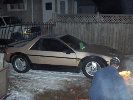

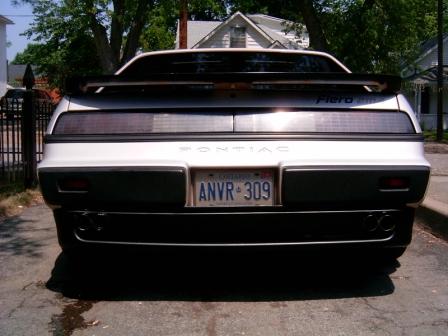

1992 Pontiac Grand Am GT rims with P245/50/R16 all around and stock ride height in photos.
They hooked everytime with a stock LT1 motor and eventually wore out the bands on the stock TH125c auto.
When these tires wear out I have a set of P225/60/R16 that also fit on stock ride height.
