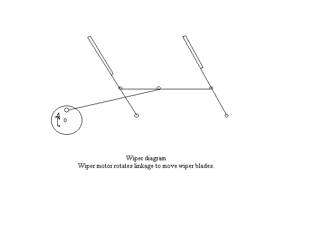

i am going to use the fiero wiper motor and drivers side arm for a lambo window.
i don't have the motor installed yet, but the window size dictates the need for a
pantograph arm. in order to use the correct size i need the total arm sweep. anyone know this.

i need to know the angular rotation of the arm in degrees. i would not bother anyone to ask
anyone if my electrical was up.

I think the stock wiper have a 120 degree sweep. Here is an overly simplified diagram that shows how most wipers work. The sweep can be adjusted by the cam arm on the wiper motor by making it longer or shorter. It is that moves the linkage arm that connects the wiper arms together.
