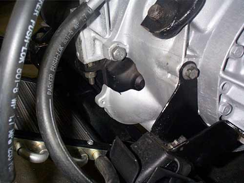

Let me say that I know little about engine swaps, but when you notch the trans case for the starter, doesn't that let dirt, water, etc. into the trans ?
On swaps where they use the stock fiero manual tranny I believe that is what they ado and the notch looks like it only goes into the bell part of the housing and not near the internals. Here is a picture of a notch someone else did:
and a pic of one on an engne:
I'm using the stock 4T60E Caddy tranny so there is no need to notch the housing

Thanks , DanFiero for the pics --man I was way off of what I was thinking they did---now I know..

OHHHHHHH ..... now I see ! Sounds like using the automatic caddy trans is without worry. Many thanks for clearing this up Fierobear, maybe we should take both our cars to see John There's only ONE guy I'd trust down here to do a swap, but he doesn't do 4.9s or 3800 S/C. Kansas isn't THAT far ...

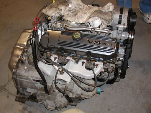

That one's not Dan's, his is an automatic. This is his.
John Stricker

DanFiero, That engine is beautifull

Well that one is a nice clean one--whos engine is in the top pic ?

I believe that was Archie's build of a customer's 4.9 engine with a six speed trans attached.

Sorry for the confusion, I was just posting the picture showing the notching of the tranny case. Didn't mean to claim it as mine

You have to notch out the trany to get one of the bolts in the adapter plate it is in the tape you get.
Actually, no. Now that you mention it, there is a very tiny bit of aluminum on the bellhousing that needs to be removed for bolt head clearance so the transmission will bolt to the plate. Or, IIRC, you can use an allen headed capscrew like I did and not grind anything. I don't have the car here at the moment, (It's at the paint shop) so I can't go look. No way can you compare that to taking that chunk of aluminum out of the transmission housing for the 4.9 starter.

The red 4.9 in the picture above is mine. I posted it to show Archie that not all 4.9 installs were hacks. He seemed OK with it. I don't blame him for being put off by that other bell housing, it was extreme. I was sort of embarrased at how mine turned out as well as it was my first attempt. The 'notch' is more like a hole and doesn't need to be NEARLY that large. I've since made an aluminum cover for it and sealed it so that rain and dirt can't get in.
But to tell you the truth, Rockcrawl has the notching down. Here's a picture of one of his from his website and I think that's about as good as it gets:
