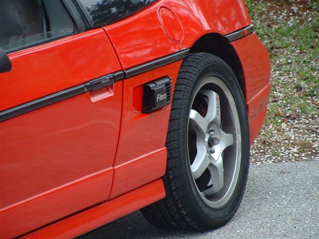

I have 215 / 45 R17 front on 7-1/2 wide chrome rims with a 40 offset, 235 / 45 R17 in rear on my 87 GT. There was only a pencil width between the rear tire and the shock tower, it was tight. I eventually went with coilovers in the rear.

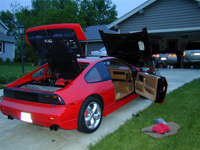

I have a set of 225/45/17's on my GT.........N/P at all
88GT/Auto/Beechwood Leather/SunRoof/Wing/JVC-CD-Sub-Woofer/225/45/17 Michelin Pilots/All Opts Ex.T-Tops

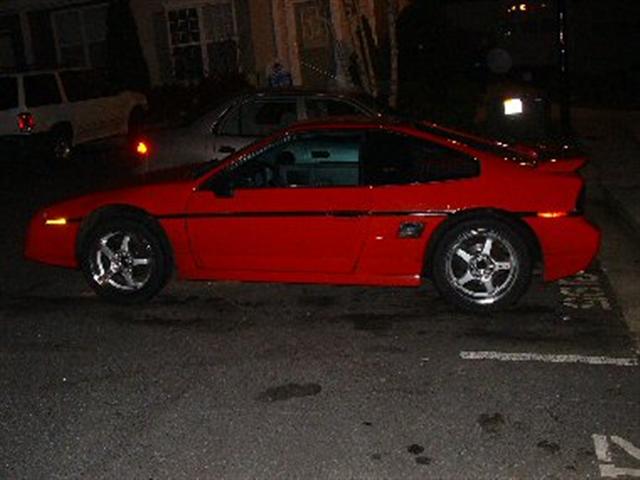

i have a 87GT with stock suspension and ride height with 245/45/17's out back and 225/45/17's up front..NO clearance problems...love the look and the handling improvement!
