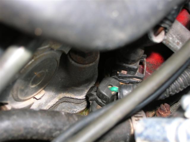

The relay is under the drivers headlight. the switch in right to the intake but left of the coolant tube, and the thermostats. It is hard to get to I could only get one hand to get to the Switch. What I did was unclamp the tube and moved it out of the way to get a bit more room. I bought new clamps to clamp the tube back in place and I had to refill the coolant. You will not lose a lot of coolant if you decide to unclamp the hose but I wanted to make sure that it was all the way up!
I know that this will not have to due with the radiator coming on or not but you can buy from web site a low temp thermostat.
If you still can not find the switch I will take a photo tomorrow for ya but I will have to do it after school. I get out at 1pm so I am sure I will have it for you some time after that.

Hi, Welcome to the Forum, if your looking for the fan/rad switch, find your thermostat neck, look a little to the left under the black tiny vacum lines towards the front of the engines lower intake, you will see 2 verticale mushroom looking black connectors, the one closest the thermo-neck should have 1 green wire leading to the top of it, thats the one you want, if you go a couple inches further towards the front, you will see another one with 2 wires 1 pink 1 purple, thats your cold start switch---you went to far--back to the green one---move the vacum lines (carefully) out of your way, a long pair of needle nose pliers will work ok here, just squeeze the 2 sides of it that protrude & lift--theres your fan rad switch,,, forgot to add, drain enough coolant so it doesn`t run all over everything when you take out your switch , also be carefull not to tighten the new one down to much, it will crack the lower (aluminum) intake---don`t ask...........Hope this helps some....

Oh wait. You do have a 2.5. Then I am not sure on what part of the engine it is on.
Sorry, I will still take a photo of the v6 one for any one that needs it.

I am happy that you got it working. But here is a photo of the v6 temp switch if any one needs it.
