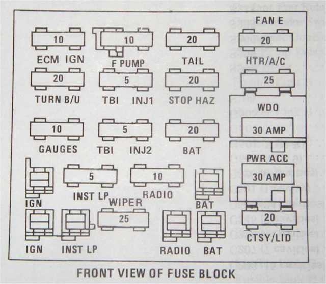

I think someone asked about this at one point.
Oh well, if not, here it is for the records anyhow: Fuseblock - fuses - fuse holder - fuse layout - where do the fuses go
(there - that should feed the search engine!)

sweet thank you the one in my book is messed up.

Awesome, that will make it SO much easier to explain things to poeple

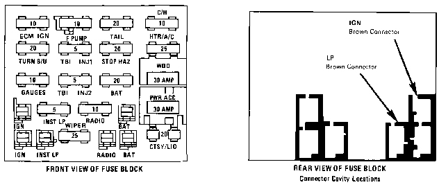

sorry, I don't mean to jump in, just adding to the list:

What's with the 5 amp fuse where a 30 amp breaker normally resides?

Yes. I did see that myself....it was in the picture when I got it....."good eye"
