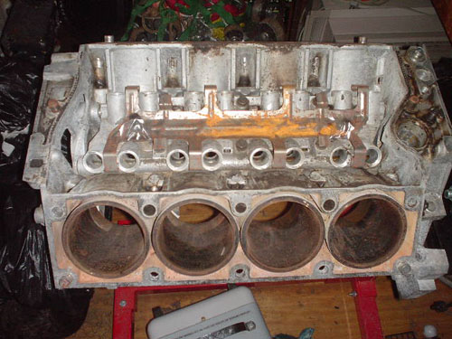

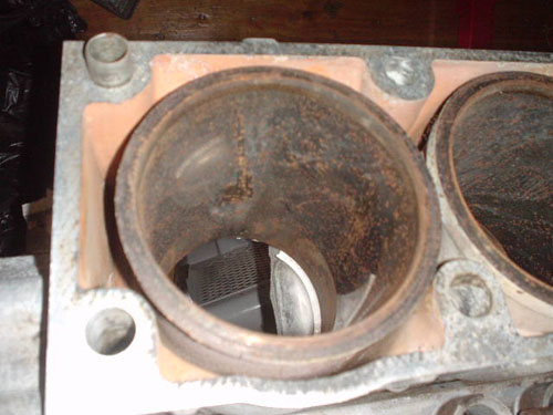

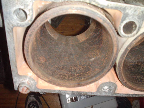

I apologize ahead of time if this is a really simple question, but I'd really like to know.
Okay, so I bought a cadillac with a 4.5 about 3 years ago and pulled the engine. I took it all apart to rebuild and put it on the engine stand. I decided to serve a 2-year mission for my church so I covered it up with like 5 trash bags and well, I've been home from my mission for about 4 months now and I took the bags off and there's some rust on the cylinder sleeves:0
I haven't yet measured the pistons for reuseability, but I was hoping to not have to get it bored out due to lack of dinero. I think I can remember spraying something on the sleeves so that they wouldn't rust like WD-40 or something before I bagged it up. I touched the rust with my fingers and rubbed a tad and it smeared off onto my fingers. What would be the best thing to clean them up with to hopefully get all of the rust off?
Thanks, and pluses are always left for helpful info,
Mike

Originally posted by FierosinKY:
I think I can remember spraying something on the sleeves so that they wouldn't rust like WD-40 or something before I bagged it up. Mike
Mike; Hind sight being perfect 20-20, you should have rub some grease on the cylinder walls for long term protection instead of the WD-40. I would suggest you get a power drill and a cylinder hone and see if that cleans them up. Use a very light lubricating fluid with the cylinder hone. Good luck. Hop

Naval Jelly, but if there is anything you can feel, as in pits etc, you will need to at least hone.

Certainly a cylinder hone will clean them up, but if there is only surface rust, then a ScotchBrite with WD40 will clean up the bores.

Take some oil and rub the cyl walls down..... If there are any pits and I mean any you will need to either get new liners (Gm sells liner and piston kits for around $125 bucks each) Times that by 8 = expensive. Unfortantly most machine shops will not bore that engine. The reason why is because soon as that boring machine hits the liner they will never stay in place and will move. Honing will not clean up rust pits in 4.9 liners.
The liners are also very very hard ( much harder then cast iron) Some machine shops might beable to bore the liners, But there going to be expensive
4.9 liners rust like overnight but you might be ok once you apply grease. Looking at the photo it looks like you have very very light rust, I think you might be ok.
[This message has been edited by 86fieroEarl (edited 01-31-2006).]
