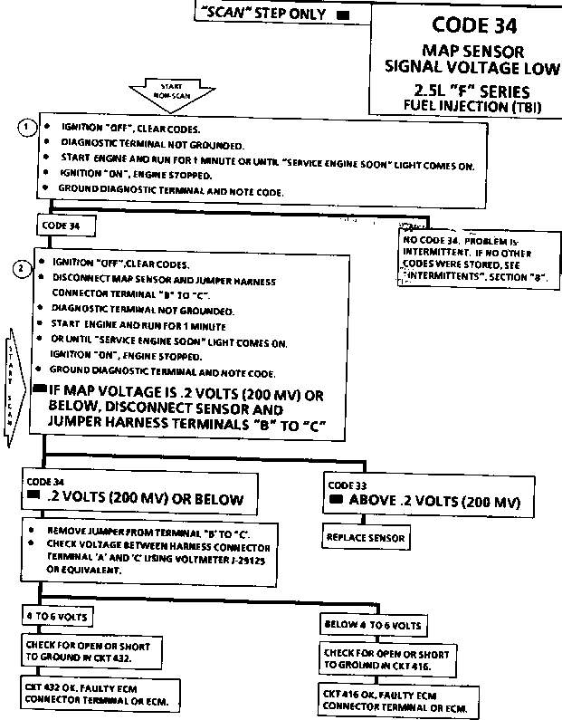

Report this Post02-02-2006 11:47 PM Click Here to See the Profile for Joseph UpsonSend a Private Message to Joseph UpsonDirect Link to This Post
It's not from a Fiero manual but it is GM and the code matches the problem so the diagnostic process should be the same as what's in a Fiero manual. This is from my shop manual for the 86 camaro. Since the signal is low, in the event that the wiring checks out and the chip is switched properly, and the problem persists retard the timing to see if that will help. The 2.8 of the same years in the camaro ran a base timing of 6 degrees, maybe giving up a little vacuum by way of retarding the timing might help with the low signal if everything else checks out. I doubt any of the stock turbo cars have 10 degrees base timing like the fiero anyway. Hope it helps.

Thanks to all for the reply's and info!, I have cleared all the codes by removing the battery cable, then I hooked up my labtop with WinALDL.
I get code 34, engine not even started, when I look at the sensor data I see the MAP tabel, there is a value of 1 and 0.0 voltage...
When I jumper on the MAP connector B&C, (green and grey) that doesnt change the voltage, it stays at 0.0 volts
Then I switched in my old ECM, one of an 85GT, but I get excacly the same results, no voltage, and the error 34.

Report this Post02-04-2006 07:35 AM Click Here to See the Profile for Joseph UpsonSend a Private Message to Joseph UpsonDirect Link to This Post
I would unplug the computer and probe the wires at the MAP and ECM plug for a continuity and resistance check.

Report this Post02-04-2006 08:39 AM Click Here to See the Profile for LordBoOsTSend a Private Message to LordBoOsTDirect Link to This Post
Looks like a faulty circuit. Check for open or shorted circuit from the map sensor harness to the disconnected 32 pin ECM harness.
A. should be fine
B- (green) to C11
C-(grey) to C14

FieroFanaticFromHolland
Posts: 174
From: Hedel, Gelderland, The Netherlands
Report this Post02-04-2006 12:15 PM Click Here to See the Profile for FieroFanaticFromHollandSend a Private Message to FieroFanaticFromHollandDirect Link to This Post
PROBLEM IS SOLVED!!!, it was indeed a loose wire from the MAP connector, I really feel stupid, but pleased that it is back alife!!!!
Some stupid who own the car before me cut the wires loose, and reconnected them to the same wire, the grey one was loose, now it runs like a champ again!
