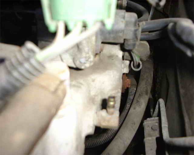

Could someone please tell me where this vacuum is supposed to go?

A more overall photo of your engine bay with the part circled would be far more useful here. I've got an Iron Duke and yet I have no idea what or where that is.

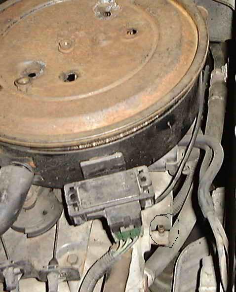

ok

likely nowhere... It is common on many engines to have spare ports.
It may have gone to cruise if you have that option. Otherwise it's capped.

On my '87 Duke, that fitting is capped.

Thus if you dont have cruise control, you should likely put a rubber cap over that to stop the vacuum leak that's resulting now.
Also, is it me or does your air filter lid have a pair of holes it shouldnt?
