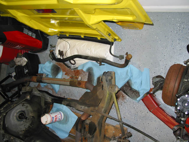

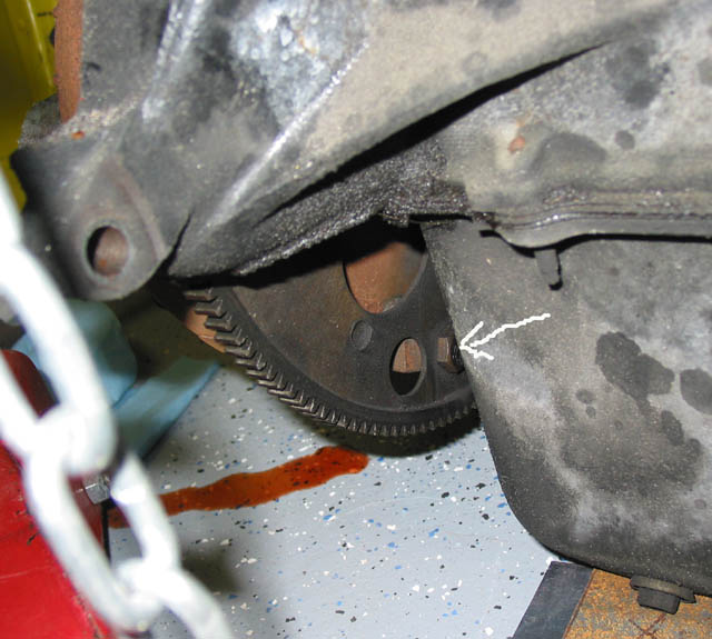

I think that tip came too late...
Also now I see I can take those bolts from this side too;
