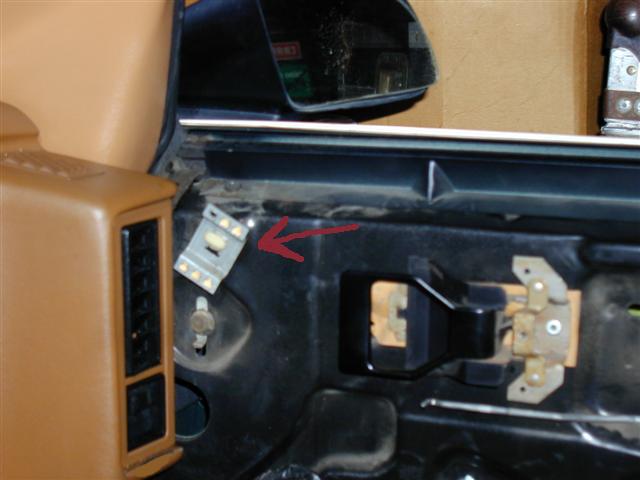

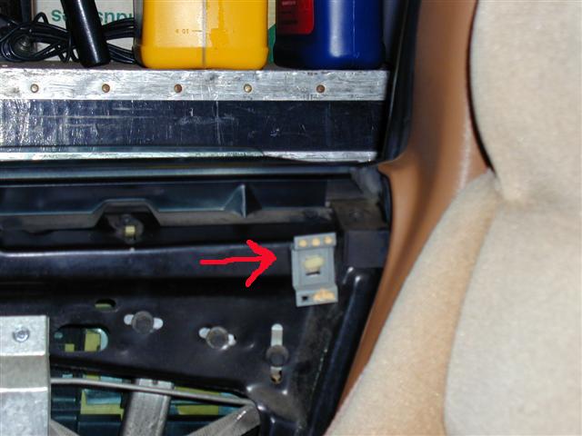

When removing my door panels, the upper clips broke off the panel (top left/top right)
What should I re-attach them with, JB Weld or glue gun, or?
What will hold the best?

These clips:

Believe it or not, hot-glue! I thought - what the heck, worth a shot right? Works pretty darn good, I could hold the entire panel just by the one glued on bracket. Just dont skimp out on the amount of glue!
EDIT:
Make sure your remove the extra partical board thats still stuck in the little holes of the bracket.
