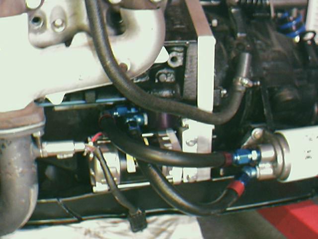

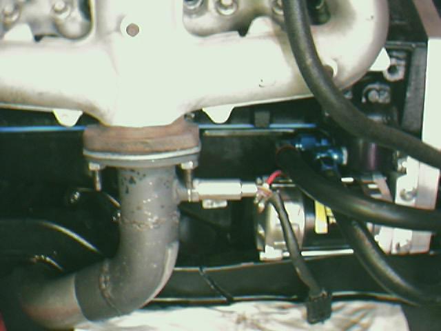

To change to the ford thread, I used an spin on adapter for the older canister style filter system to convert to the spin on filter. It comes with a variety of thread options. This part just bolts in place of the OEM bypass spin on adapter.
In the lower Right of this pic is the new spin on adapter ($5 to $10 on ebay)
Once the spin on adapter is installed, the rest just spins on like a filter.
With this setup, you also don't have to run any hoses. I used 1/2" pipe with hydraulic fittings to a dual filter assy (inlets from the side) and a bracket off the tranny for support.
