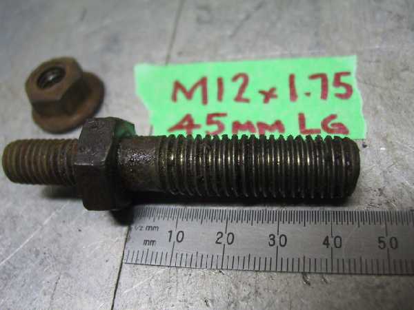

What size (thread pitch, etc) are the bolts that connect the engine and the transmission? This is on an 88 GT 5-speed if it makes a difference. Thanks!

There are three bolts with a stud like the one in the pic and three without. The bolts are measured from under the head to the tip as shown.

Wow, that was exceptionally helpful. + for you!
