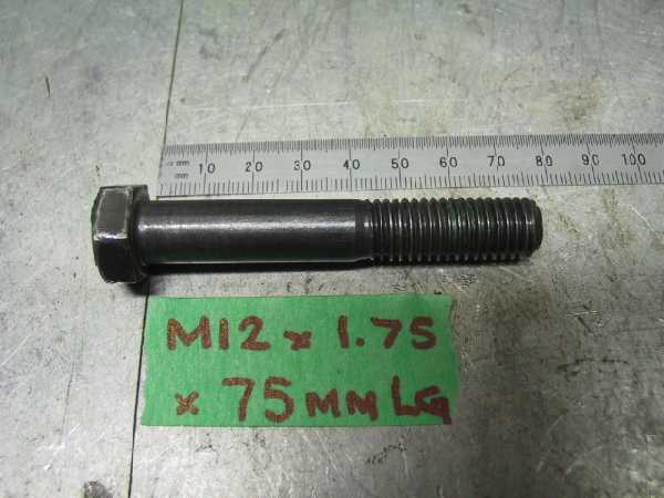

The ones I measured are a different pitch. See pic below.

Report this Post12-16-2005 05:09 PM Click Here to See the Profile for StuGoodSend a Private Message to StuGoodDirect Link to This Post
Oops, my bad. rubyredfiero is correct, the pitch is 1.75, not 1.5 as I originally posted. Sorry about the error !
