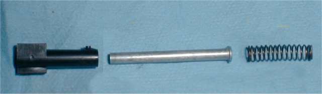

I just installed a 3 spoke steering wheel in my Formula, but I don’t have the spring for the horn button
Will a spring from any Fiero steering wheel work?

Hmm...dont really know except that spring that you show looks like the one I have in my 3 spoke.

Yes, this spring is from a 3 spoke, but I only have a picture of it... lol
What I'd like to know is can I just take a spring from "any" Fiero and with it fit?

I dont know either, but if you need the spring in the picture, PM me your addy and Ill throw it in the mail. John

They are the same

Basically, in the Fiero there are paddle horn buttons and center horn buttons. The paddle buttons don't have the same connection and own interchange. Any of the three-spoke or non-paddle four spoke wheels will work.

Hey thanks.......That is nice that you offered this.....I had time today to stop at the "bone yard"
an I picked up one.....along with a couple of other parts
