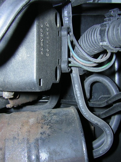

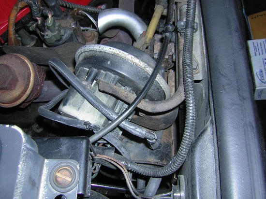

Went out and snapped some pics for ya !

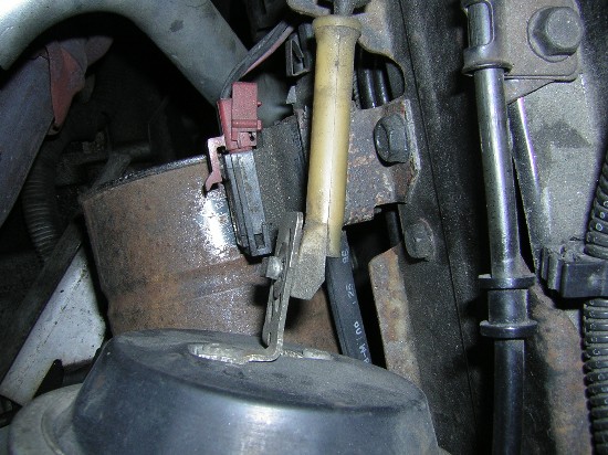

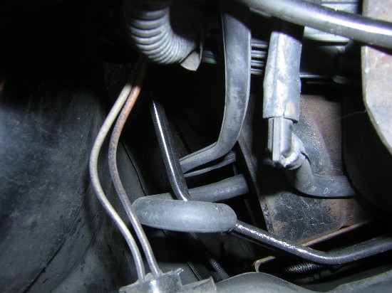

more pics
Ok so start at the solenoid valve ( has red plug) , hose goes from solenoid to bigger fitting on cruise control device.
Little fritting on cruise control device goes to the little fitting on the vacuum canister.
Big fitting on vacuum canister goes to the metal vacuum line attached to the back firewall. Hope that helps.
