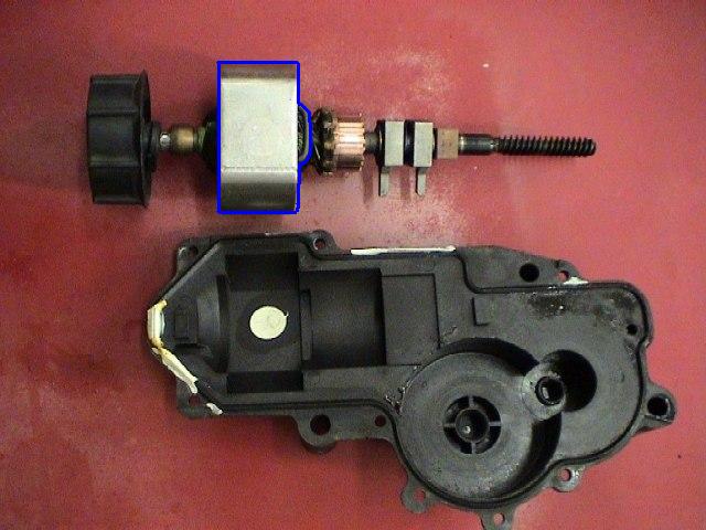

It was kinda hard to decipher what your problems are by your discription.
But it sounds like you are having two problems.
First. Your right motor is running backwards
You turn the headlight switch ON and the right side stays down.
You turn the headlight switch OFF and the right side comes up.
If this is correct you have this magnet in backwards.
notice the blue dot on the magnet in the second pic.
In the first pic you can barely see that it’s a bit lighter than the rest of the magnet.
That’s where the blob of white silicone in the plastic case was glued to it.

Hi all,
Just pulled apart the motor this morning, and the magnet was placed in correctly, blob on blob of silacone.....I think I might of wired the motor backwards now, well see when I put it all back together......

So the magnet was in backwards, but this did not solve all my problems though.....When I placed the magnet in the correct way, and added power to the car by connecting the battery the head light went down automatically.....Now the right headlight motor keeps coming on then off, like it is trying to move on its own...I pulled the fuse and still nothing, the fuse was good....
When I do try and hit the light switch to open the lights the driver side moves up just like it should and the lights come on....But the passenger side just stays there, try it again, and it wants to move up but it seems like something is jammed, no grinding noise as I replaced the old gear with Rodney's new gear..............Anyone???
edit: So I think that I am shorting somewheres, is there a common place to check in this area of the car??
