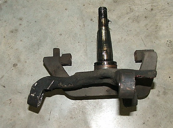

Cast parts can bend without breaking.
Someone posted within the last month or two was of the opinion that cast parts could not bend.
I tried to convince him they could without much success.
Unfortunately, member FieroMGDriver has proven this.
He was hit by an elderly woman.
Here is his bent spindle
or you can read the whole thread.
https://www.fiero.nl/forum/Forum1/HTML/055406.html

One of the guys in our club loaned his car to his son, who slid it sideways into a curb, while "only going 35 MPH".
Aside from all the stuff that was just outright broken, it bent the machined spindle down by almost 1/2 inch.
I never would have believed it, either, until I saw that.

I think people get confused with names. While the spindles are cast they are still a higher grade of steel and will bend.
People often confuse casting with the old term "Pot metal" casting which is very brittle due to the poorer metal used and the type of process.
Here is some info if your interested.
(Wow that machine tool degree from years ago did pay off. )
TYPES OF CAST IRON:
1) Grey Cast Iron:
The grey cast iron has a low tensile strenght, high compressive strength and no ductility. It can be easily machined. It is very suitable for those parts where sliding action is desired. The grey iron castings are widely used for machines tool bodies, automotive cylinder blocks, heads, housings, fly-wheels, pipes and pipe fittings.
2) White Cast Iron:
It has high tensile strength and low compressive strength. It is used in car wheels, rolls for crushing grains and jaw crusher plates.
3) Chilled Cast Iron:
It is white cast iron produced by quick cooling of molten iron. Chills are used on any faces of casting which are required to be hard to withstand wear and friction.
4) Mottled Cast Iron:
It is product in between grey and white cast iron in composition, colour and general properties. It is obtained in castings where certain wearing surfaces have been chilled.
5) Malleable Cast Iron:
It is ductile and may be bent without breaking or fracturing the section. It has excellent machining qualities. It is used for machine parts for which the steel forgings would be too expensive and in which the metal should have a fair degree of accuracy, e.g. hubs of wagon wheels, small fittings, for railway rolling stock, brake supports, parts of agricultural machinery, pipe fittings, door higes etc.

Right on Dodgerunner. The make up, or alloy, of the material cast, be it iron, steel, alluminum etc effect the bend break topic. There are basicly 3 types of stress, Tensil ( tention) compression, or shear. Each alloy is designed for a particular strength. The "ductility" of the metal can be very differant for differant applications.

the item of question was infact a spindle.
and the person refused to believe that a spindle could be bent. keeping a car from being aligned within spec.

There's a vast difference between cast steel and cast iron even though to the naked eye they look similar. The process of converting iron to steel removes carbon from the mix. The high carbon content of cast iron is responsible for its brittleness.

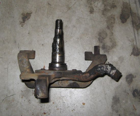

In case you would like another picture to further prove your point. This is my passenger side knuckle after a lady plowed into me at ~40mph.

derangedsheep can't believe you didn't just hammer that out...... Unbelieveable, bet the wheel was a real leaner!

that's a good one.
i'll say that even i'm surprised that it didn't brake
