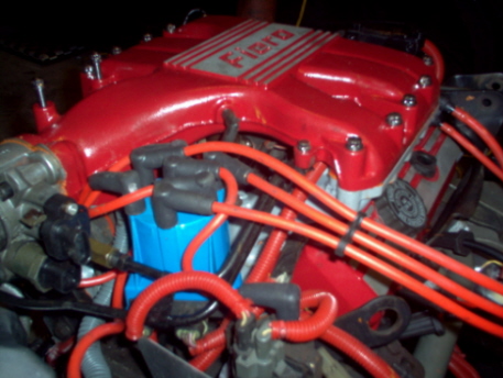

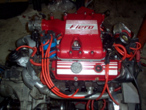

I replaced all my vacuum lines before I put my engine back in yesterday. It was really easy to do, as long as you put them where they are suppose to go. Mine was missing over half of them when I got it.
You can pick up a pacage of different color vacuum lines at most auto places for $15, and they don't melt from the heat of the engine. Pretty nice for $15.
