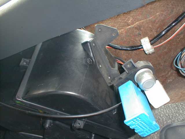

Of course there is also this blue dingy thingy

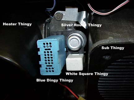

Just out of curiosity....what is the white square thingy? Is the silver round thingy a flasher thingy? Inquiring minds want to know!
