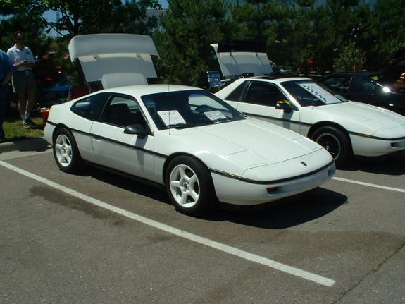

There's a pic around somewhere of a white Formula that had a GT rear clip. The front and rear fascias were still the coupe style, and it didn't have the GT ground effects. Really nice looking set-up.
I'll see if I can find that picture when I get home.

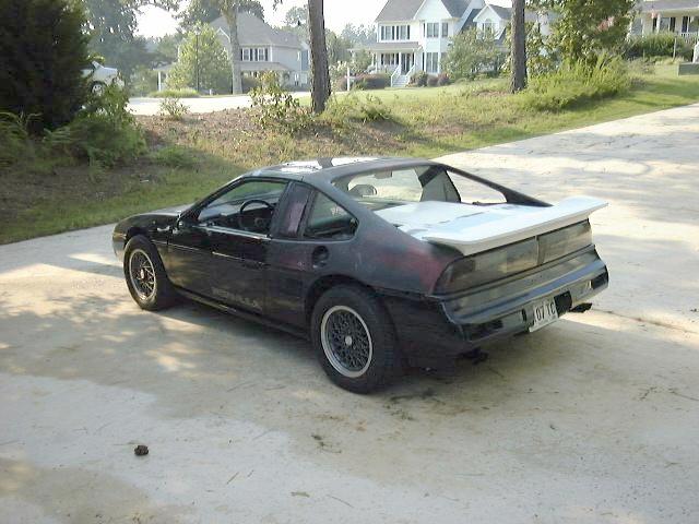

Report this Post10-14-2005 12:12 PM Click Here to See the Profile for RaydarSend a Private Message to RaydarDirect Link to This Post
Working on it...

Report this Post10-14-2005 12:25 PM Click Here to See the Profile for JussTrySend a Private Message to JussTryDirect Link to This Post
Nice wing ray whats it off of?

Posts: 41355
Total ratings: 460
Report this Post10-14-2005 12:44 PM Click Here to See the Profile for RaydarSend a Private Message to RaydarDirect Link to This Post
thanks! That's the fastback whaletail that Fiero Warehouse sells.
This car was once an 88 4 cly coupe:
The 500 connector (car side) needs a minor wiring mod for the fastback tail lights - if you use a real GT rear wiring harness. In coupes the turn and brake lights are in the same curcuit, but on the GT's they seperate circuits, so 1 wire must move. Your can splice on the extra lights for the GT into the coupe rear harness, but then your Orange and Red lights will light up and behave as one.,
Interesting... I used a GT tail light harness on my Formula and didn't have to change any wiring. All the lights work as they should. (Just went down to the garage to verify.)
The harness must have been an 88 harness, since it didn't have the wiring for the alternator and coil blower, although I was told it was for an earlier year. Wouldn't an earlier harness have the blower wiring?

GT86
Posts: 5203
From: Glendale, AZ
Total ratings: 165
Report this Post10-14-2005 08:57 PM Click Here to See the Profile for GT86Send a Private Message to GT86Direct Link to This Post
Here's that pic I mentioned above. Don't know whose car it is, but I really like the look:
JussTry
Posts: 88
From: lisbon falls,ME
Registered: Jul 2005
Report this Post10-14-2005 10:18 PM Click Here to See the Profile for JussTrySend a Private Message to JussTryDirect Link to This Post
Originally posted by Raydar:
It appears that that is the case.
I didn't have to do anything to mine. As soon as I plugged it in, it worked.
It shouldn't be too ugly, though. All the wiring should already be there. Probably just need a wire or two re-pinned.
I'll try to post info within a couple of days unless someone beats me to it.
Were you going to try to do this, this weekend?
Most likely gonna get started next weekend but im not sure if I'm gonna start with the body or motor first.
JussTry
Posts: 88
Report this Post10-14-2005 10:19 PM Click Here to See the Profile for JussTrySend a Private Message to JussTryDirect Link to This Post
JussTry
88 posts
Member since Jul 2005
That does look pretty sweet. Thx for posting the pic GT86.
