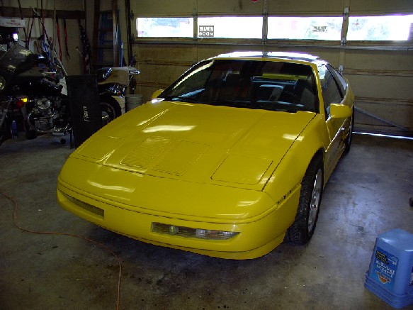

I have completely rebuilt both the front and rear suspension on my 88. I did poly all around Powder coated all the front and most of the rear. New ball joints and Rodney's steering rack rebuild bushing. To lower mine I cut 1 loop out of all the springs I have had no alignment problems and am currently using Monroe shocks and struts on my 4.9 powered Formula/GT. The ride is smooth and it takes bumps with out any harseness. My son's 88 has KYB shocks and struts and you feel every bump in his car.
This is how my 88 looks now
