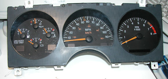

I want to use this Grand Am cluster in my 3.4 DOHC Fiero:
The speedometer should work fine with the buffered output from the ECM, no problem. I think all the senders are the same for oil, temp, and fuel as well.
I have two remaining problems: converting the tach to work with the V6, and resetting/changing the value on the odometer to match my old one (the GA uses a digital odometer/trip counter).
I haven't yet retrieved the connector so I haven't been able to power up the instrument cluster to see what the odometer reads, if it even works. The Grand Am cluster actually plugs into the dash through a single connector built into the dashboard, unlike the Fiero which has free male connectors that plug into sockets on its instrument cluster. I'll pull a dash this weekend so I can get the connector out of it (and the external trip counter switch) and get it hooked up for testing.
Does anyone know what component needs to be changed to get the tach to read properly for a DIS V6?

Here's something cool. The tach comes out with 5 screws and has all of the necessary circuitry and hardware to run itself in this small package.
Just add tach signal, 12v+ and ground. This would make an excellent candidate to swap into a custom dash. Its also incredibly easy to make a new face for it because its just held on by two screws and made of thin multilayer material that can be replicated with supplies from Office Depot or Staples, and a decent ink jet printer. The tach has a mechanically limited sweep (in the driver, not by pins on the face) that would allow it to go to about 10K RPM with the stock scale if you had a face that was marked for it.

It is 13.75" wide.
I picked up the connector for the cluster today, as well as another instrument cluster that is basically the same except with analog odometer and trip counter. I will use that one if I can't adapt the digital one. Still looking for wiring diagrams, and information on converting the tach..

I have no idea if this is at all correct, but my thoughts would be...
The tach filter. IIRC, when one does a V8 conversion, you must replace the tach filter with a V8 one, not an L4 or V6 filter. No modification to the tach itself necessary, regardless of what engine your Fiero originally had. Fierobsessed put a Sunbird cluster in his car that looks a lot like yours because he needed the tach like you for his Quad 4 DOHC. He modified the cluster so he could put the Sunbird gauges in the Fiero cluster, but I don't recall him modifying the tach itself in anyway. Really, all the tach does is go up or down depending on the input. Only thing different is the scale on the face.
The tach filter is not involved in signal conversion in any way. It just "cleans" up the signal so the tach electronics don't get erratic pulses.
The tach reading changes depending on the number of pulses it gets from the distributor/ignition module. Because there are more firing events per revolution in an engine with more cylinders, the tach has to be modified for the new number of pulses per revolution.
The Sunbird tach has to be modified to work with a V6. Fieroobsessed wouldn't have had to modify the Sunbird cluster for his Quad 4 because the Sunbird tach is designed to work with an L4. That does give me an idea though.. perhaps the Sunbird tach has a circuit more similar to the Grand Am tach than the Fiero tach is... I'll have to find out what is done to convert that one.

Since I couldn't find a wiring diagram/connector pinout I traced it all out myself and came up with this for the cluster with the digital display:
Pin # Description Wire Color
1 Gauge Ilumination (12V positive to activate lighting) Gray
2 Ground Black
3 - -
4 ???? Digital display Pink / black stripe
5 "Trip Set" button for display Tan / white stripe
6 - -
7 Tach input Light blue / black stripe
8 ???? Digital display Tan / black stripe
9 ???? Digital display Grey / white stripe
10 - -
11 Low coolant lamp (ground to light) Grey
12 Service engine soon lamp (ground to light) Dark brown / white stripe
13 Oil pressure gauge Tan
14 Coolant temp gauge Green / white stripe
15 Fuel level gauge Pink
16 ???? Digital display Dark green
17 - -
18 ???? Digital display Black / white stripe
19 "Eng/Met" button Light blue
20 Brake indicator lamp (ground to light) Tan / white stripe
21 Ground Black
22 Gauge Ilumination (12V positive to activate lighting) Grey
23 - -
24 Seatbelt Lamp (12V positive to light?) Yellow
25 High Beam indicator (12V positive to light) Light Green
26 Right turn signal (12V positive to light) Dark Blue
27 ???? For digital display (possibly backlighting) Orange
28 ???? Digital display Brown
29 "Trip/odo" button Purple
30 Speedometer signal (buffered, from ECM, 4000ppm) dark green
31 Ground Black
32 Left turn signal (12V positive to light) Light Blue
33 Charge indicator Brown
34 Battery 12V (+) hot in start/run Pink / black stripe
Note: "Eng/Met", "Trip/odo", "Trip Set" buttons are momentary on switches to ground
I still don't know how to wire up the digital display properly, but I'm hoping to have time this week or next to get a closer look at the Grand Am to see where the wires go.

I took a look at the Sunbird tach. It's completely different. Different circuit, different mounting provisions, different connections. The Grand Am cluster doesn't use pins that press into the back of the housing like the Fiero or Sunbird clusters do.
Do you have any pics of your Grand Am cluster? Maybe it was from a V6; they have a different one. I have two Grand Am clusters from a Quad 4 now and neither of them use pins like the Fiero cluster...
I did make a breakthrough in getting the recalibration worked out. Check out this link:
http://www.autosoftsys.com/supra/tachcompare/
The Toyota Supra used the exact same circuit board, IC, air core, etc as this tach. If that pic didn't have a caption I would've thought it was this Grand Am tach on my desk. There are a few differences in component values (mostly resistors, but one capacitor is different) though, so I still haven't narrowed down the component to change..

My cluster is from a 1990 Grand Am SE with the Quad 4 HO and a 5-speed. Looks the same as yours but in KM/h and with an analogue odometer. Also, the Canadian models have an idiot light that tells you to turn your headlights on.
I went with the sunbird because it was from the same year as my Fiero, and the font and everything looks simmilar to a Factory V6 Fiero
A problem you are going to have is getting a faceplate for that cluster, mostly because the idiot lights are eveywhere on that dash.

D'oh! Just got word from Toshiba:
"Hello, Steven!
T2685A is an obsolete part and therefore the data sheet for it is unavailable.
Regards,
The TAEC Tech Support Team! "
Dude.. all the idiot lights are in the cluster.
Everything works without mods except the tach because its set for a 4cyl not my V6. The idiot light wiring and all is the same.
