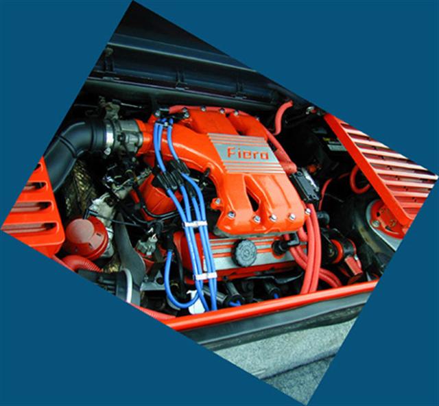

Actually, the high temp stuff does not only come in black! Taylor makes high temperature (called and talked to their tech department, its rated for over 200 degrees and will not burn) tubing in a few different colors. You can order it through Summit or any store that deals in Taylor products (I got mine from Rossi's Engine & Drivetrain in Gilroy, Ca). It was $40 for a bag of 10 feet each of 1/4", 3/8", 1/2" and 3/4". Thats plenty enough to completely recover an engine wiring harness. You can get it in black, purple, red, yellow, blue, white and teal. I used this stuff for the wiring harness in my HOT 3.4 TDC engine bay. I accidentally ran some right against the exhaust crossover and it only melted right where it touched the crossover pipe. It did not burn or even melt through to the wires. This is just the stuff to use for our cars.
