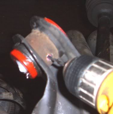

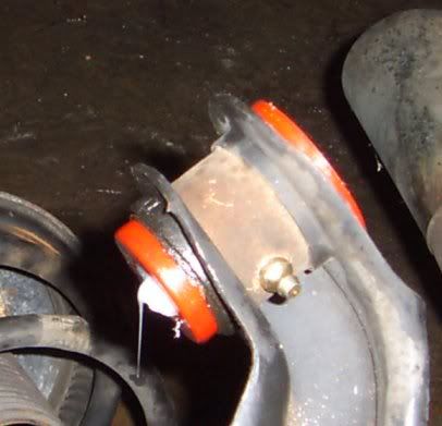

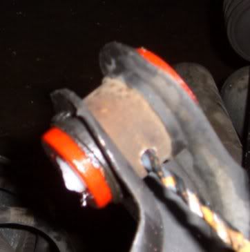

Yes, but it was installer-induced. Not sure what I was thinking when I installed the zerk fittings on my front UCAs, but there's no way in hell that I can freshen the grease in them without disassembling the front suspension. Zerk fittings on the LCAs & stabilizer bar pillows are all easily accessable however, and I give them a shot of grease as part of a normal lube job now. Only the front UCAs make any noticable noise.

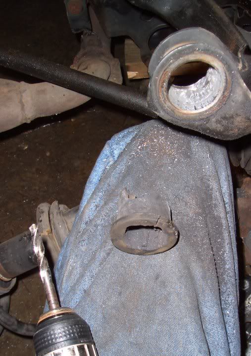

first you run the drill bit around the rubber to remove the old rubber from the metal sleeve that must be retained
http://img.photobucket.com/albums/v435/kohburn/Cam_0452.jpg
then you press your poly in with grease and
drill through just the sleeve with the correct drill bit for the size fitting thread you purchased

then drill all the way through the first side of the bushing and through both sides of the inner metal sleeve with a 1/8" bit and blow the shavings out
http://img.photobucket.com/albums/v435/kohburn/Cam_0455.jpg
install fitting
http://img.photobucket.com/albums/v435/kohburn/Cam_0459.jpg
install arm and grease
http://img.photobucket.com/albums/v435/kohburn/Cam_0461.jpg
this method has always worked well for me and has a few side benefits - for example the pivot bolts have never rusted to the inner sleeve due to being lubed - makes for much easier maintanance later down the road
