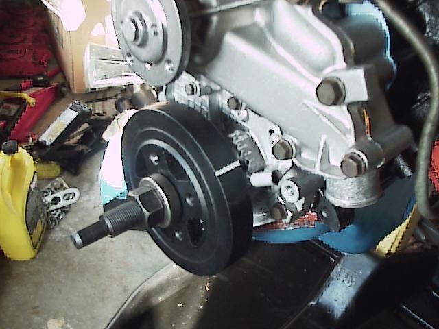

Timing tab:
Closeup:
Note, the timing tab is reversed on the Fiero because the timing light is used from the rear, as opposed to from the front on FWD cars.
Just in case anyone swapped in a FWD motor and didn't swap the timing covers.

The timing tab has numbers stamped on it for the major marks, I think 8, 10, and 12 degrees are stamped. You'll have to wipe it down to see them clearly. Sorry I don't have a better picture, I was still learning the focus capabilities of that camera when I took those pics.

Here is a little better picture of what the marks look like. These are on the wrong side as Jazzman noted but I have no problem seeing them.
Here is a close up so you can see the notches and numbers.
