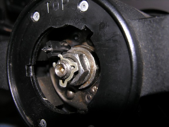

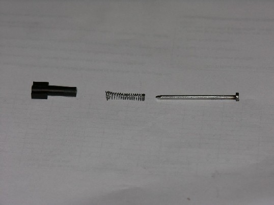

Here's what you need. The metal pin, the spring and the plastic retaining cap. The picture below shows how they go together. Then the spring goes over the pin and the platic cap goes over them both. The whole assembly slides into the hole in the colum with the fat end of the pin down and the cap is pushed in and then turns to lock in place.
Here is a picture of them in place.

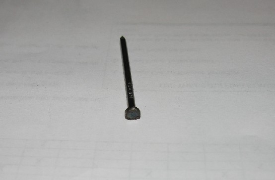

Since I had misplaced my pin and spring I used a 2" nail with the end ground and a spring from a click pen. The end of the spring had to be flared out so that it wouldn't slip through the retainer. Not pretty and may not be exactly as the original but it works.
Heres a shot of the ground end of the nail:
Hope this helps.

Is there any kind of metal ring under the cap, or any wires connected that I can't see in the pics? Won't the metal pin have to ground to something?
JazzMan
Posts: 18612
Total ratings: 653
Report this Post07-26-2005 10:32 PM Click Here to See the Profile for JazzManSend a Private Message to JazzManDirect Link to This Post
There is a metal ring inside the column, it's part of the cancel cam.
JazzMan
Sourmug
Posts: 4538
Feedback score:    (29)
Total ratings: 144
Report this Post07-26-2005 11:44 PM Click Here to See the Profile for SourmugSend a Private Message to SourmugDirect Link to This Post
There is a metal plate that is part of the horn button. It makes contact with the pin and the column shaft to complete the circuit.

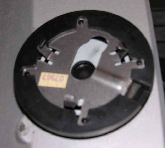

Here is a picture of the back of a stock GT horn button:
as you can see, there are actually two metal plates, these plates are not normally in contact with each other. The plate between the front button and the rear plate makes contact with the metal pin. You can see a small wear spot where the pin touches. The second plate makes contact with the shaft. When you press the button the two plates make contact with the pin, the steering column shaft and each other completing the circuit. No wires are required.
