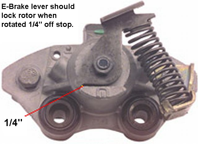

Most Fiero brake problems are caused by the rear calipers being defective or out of adjustment. Symptoms can mimic a bad master cylinder with the pedal going to near the floor and still barely stopping.
If the caliper emergency brake levers aren’t normally resting on the return stops and/or they move more than 1/4" from the stop when operated, they are either not adjusted properly or the caliper is shot.
The adjustment is not made on the cables (the cables should hardly ever require adjustment). See Ogre’s Cave or the archives here for caliper e-lever adjustment procedure.

It doesn't matter that you replaced the rear calipers.... You've still got to check the clearance using the info in my cave. Don't assume that replacement calipers are any good or that they will properly self adjust. If there is too much rear pad clearance then you will have problems like low pedal.

i really didnt make any sence of the procedures given in that link, and the pic of the rear discs didnt look like anything ive ever seen, and btw my (rear) caliper brake pad (near the piston) slaps around, like i can move the pads 1/4 inch between the piston and the rotor by hand, but the pads on the other side of the rotor are touching, and ive also noticed that when e-brake is applied and relised, and driver caliper doesnt relese the lever all the way, only goes about 55% back when relised, whats the directions for adjusting for an idiot to understand? "the idiot guide to brake adjustments)
btw when i apply my ebrake both rear caliper arms with the spring and cable completly close and squish spring, but yet i can still turn wheels by hand with ease. weird?

The 88 looks a bit different but the procedure is the same. Take the cables loose but leave the springs on. Then use the spring tension to snap the levers back against the stop. Do that until each lever only moves 1/4" to lock the rotor. After doing that on both sides, reconnect the cables. If the cables pull the levers off the stops, readjust the cable till the levers just touch the stops.

A misadjusted set of calipers will cause the pedal to drop as noted but as to replacing the brake lines, unless there is fluid loss visible somewhere at the brake lines or at the master or proportioning valve then there is still system integrity and the lines don't need to be replaced. Sure, stainless lines are great and give a much firmer pedal especially when used in high performance driving situations but since the kid ain't got the cash to spare and the part ain't broke, he don't need to fix it. If you can't get the adjusters to self adjust, you can pull the caliper and rotate the piston manually to close the gap between the pads and the rotor. There is actually a tool made to put into the notched parts of the piston so as to be able to spin it. Or, if very, very careful, a pair of good channel lock pliers will hold the piston tha spin it too.

Oh yah, from your description you definitely need to adjust the rear calipers.

if to say i did adjust the rear calipers properly, would it take care of the e-brake problem and the no brakes problem?
YES
The Car Quest procedure is the easiest way to adjust the caliper. Try holding the lever with Vise-Grip pliers and work it back and forth rapidly. If that doesn’t free the internal parts so that spring pressure will return the lever to the stop, you need to use the procedure described in Ogre’s Cave.

ok me and wolf adjusted our rear calipers and his are now fine and work great, thanks for the help!, but mine on the other hand didnt do a darn thing!, i ratcheted the e-brake levers like 100 times each side and no movement in the pads or caliper, the caliper doesnt even lock up when levers are moved! , whats my next step?? im dealing with 88' brakes btw.

From this description, I would say that the sliders on the caliper are sticking, preventing the caliper from releasing the outboard brake pad from the rotor.The piston is having to travel twice the distance, to press the piston-side brake pad against the rotor. It may also be, that the piston is rusted onto the adjusting screw, which passes right into the piston. The piston should be locked onto the two little raised parts on the inboard brake pad, which stops the piston rotating with the adjuster, allowing the piston to be repositioned further down the adjuster screw,keeping it in contact with the brake pad backing plate and taking up any space left by wear of the pads.If the two locking points are not sitting in the backing plate, the piston rotates with the adjuster screw, when the e brake is applied, and so the piston is not pushed further out. I suggest pushing some hardwood block between the rotor and the disc pad, ensuring the two locking points are klined up, and then try adjusting the brakes with the ebrake action. If,when you pull on the ebrake, the piston rotates still, you either haven't got the dimples lined up. or the adjustor is rusted inside the piston.

This is real good info. the only thing they did not mention was when you rachet the lever tight You must stick a screw driver in the caliper and hold the brakes tight against the rotor or you will never get it adjusted. One way to do it inside the car is to pull the e-brake lever then put your foot on the brake pedal with force, then release the e- brake lever. Repeat this procedure several times until you get 4 to 5 clicks on the e-brake lever then you should be ok.

well there is a huge gap between the rear pads and rotor, and i have to pump the **** out of the brakes to build up enough pressure for 1 good stop....every good stop requires that..is that related to my retarded rear pad gap or are thoes 2 problems completly not related to one another?

Ok from what you have said. the caliper piston is not comming out to its full position. There should be no slack in the pad and caliper when properly adjusted. you also need to measurer the thickness of the rotor and see if it has been turned down too much. The first thing I would do is return those rear caliper's and get another set. If all fails then you need to put some shims like ogre states in his cave. If you pull the e-brake lever hard and the pads still do not lock the wheel, then you have got a problem with the caliper piston or the e-brake actuator. These brakes will work if properly adjusted. Sorry to say but if you do not understand how these brakes work, then you are in trouble. Good Luck

There is also the possibility the the return springs on the lever(s) are no longer strong enough to pull the cable back far enough which may indicate a need to replace the cables.

Report this Post09-09-2005 04:08 PM Click Here to See the Profile for ice8420Click Here to visit ice8420's HomePageSend a Private Message to ice8420Direct Link to This Post
Thank you ! I will try this and get back to you. The adjuster is in the back center of the car... right?

Originally posted by Indiana_resto_guy:
On the rear of the caliper, check and make sure the levers on both sides are against the stops.
First try to disconnect the cable end from the lever and see if they will push the lever to the stop (checks spring tension) and reattaach if they do. The lever(s) will need to be forced down against the spring tension to do this part.
If theat checks out to be OK, adjust the cables till they just reach them using the adjuster. The brakes wil then no longer drag.
OK.. here's what I did today. I adjusted the parking brake levers again according to the process in the cave. That worked good. It seems that my problem is with the parking brake not releasing.. it engages fine, when I push the button on the handle and put it back down, they do not spring back - I have to walk back to the caliper and pull the lever myself. Think the springs on the lever are no good??

Report this Post09-29-2005 11:21 PM Click Here to See the Profile for JazzManSend a Private Message to JazzManDirect Link to This Post
Either that, or there's rust in the cables and the springs aren't quite strong enough to overcome the friction that results.

Report this Post09-30-2005 01:18 AM Click Here to See the Profile for ice8420Click Here to visit ice8420's HomePageSend a Private Message to ice8420Direct Link to This Post
I think that's it.. because when the cable is not attached to the lever, it springs right back. I'll see if I can somehow get some penetrator in there, maybe it'll help with releasing.

Report this Post09-30-2005 10:26 AM Click Here to See the Profile for dguySend a Private Message to dguyDirect Link to This Post
Good luck, but if it were me I'd consider investing in replacement cables.
I've tried every trick in the book to "loosen" stiff e-brake cables, and IMO the effort is not worth the result (it's never lasted). OTOH purchasing a set of good quality, teflon-sheathed cables will likely last the remainder of the car's life.
