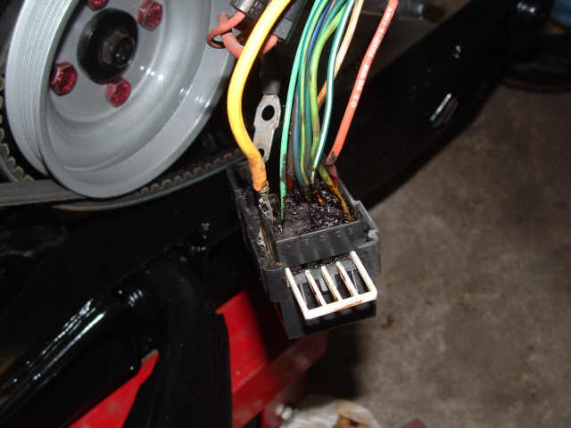

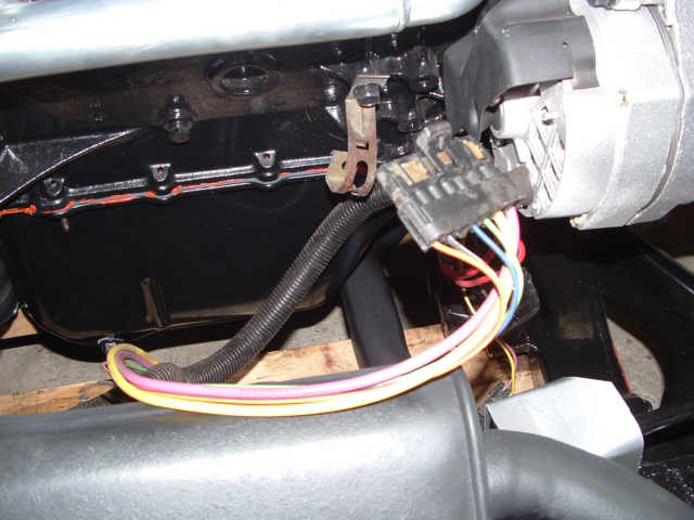

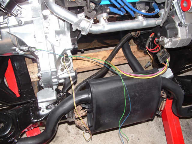

Ok, here’s how you convert an automatic transmission harness over to a manual transmission application.
1.) Take the wiring bundle from the backside of the engine and strip back the insulation wrap to the alternator.
2.) You will need to cut the speed sensor connector off, leaving enough wire on the connector to splice on additional length. (I used the connector & wires from my old manual harness for this)
3.) Cut off the connector for the backup light switch from you old harness leaving as much wire as you can.
4.) Cut off the large connector that attached to the automatic transmission. You should be able to identify the backup light wires by color. Splice them to the pigtail on your connector. It’s best to solder all connections.
5.) Attach the speed sensor connector to the sensor and splice in longer wires to reach the wires in the harness.
6.) The heavy gage yellow & pink wires supply current to the starter solenoid. Splice these two wires together. You are bypassing your non-existent neutral interlock. The auto tranny uses a neutral safety switch in the transmission to prevent you from starting in gear. Your manual chassis has a safety switch at the clutch pedal instead.
7.) Insulate all connections with heat shrink tubing & re-install the wiring wrap.
Gordo
Posts: 2981
From: East Guilford, NY, USA
Total ratings: 114
Report this Post08-17-2005 07:18 PM Click Here to See the Profile for GordoSend a Private Message to GordoDirect Link to This Post
Gordo
2981 posts
Member since Mar 2002

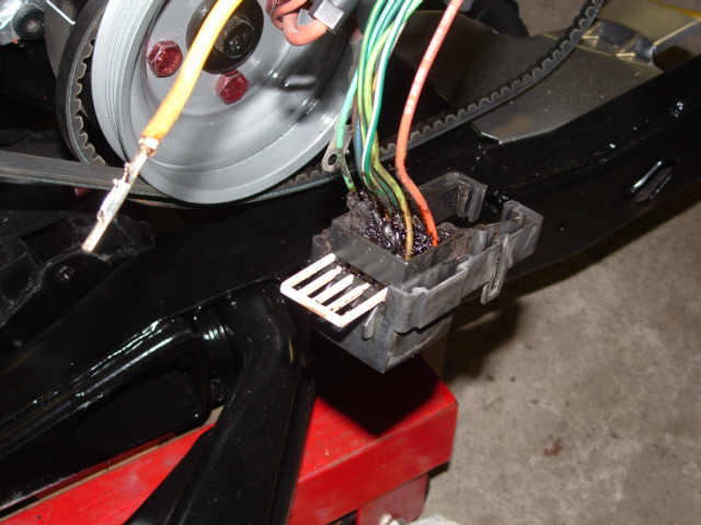

8.) Next, find the white contact retainer on your C500 connector and pull it out
9.) Carefully pull the yellow wire out from the connector.
If you clean some of the black sticky stuff off the sides, you will notice that the rows & columns of contacts are lettered & numbered. Brake cleaner works good for the cleanup.
10.) Move the contact from the A4 to the E2 position. This will connect it with your clutch safety switch.
11.) Slide the white plastic retainer back into the connector.
That’s about it. On the front side of your engine you will find a connector for the converter lock-up solenoid. Bind it off in a safe place with a zip tie so it won’t melt.
Good luck!

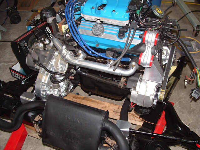

ok i finished the conversion. the engine runs and i havent seen any codes. i used the auto ecm and auto wire loom. but instead of conecting the yellow wire to the purple we omitted the yellow wire all together
sergioazevedo
Posts: 201
From: calgary alberta canada
Registered: Jun 2004
Report this Post09-04-2005 05:18 AM Click Here to See the Profile for sergioazevedoSend a Private Message to sergioazevedoDirect Link to This Post
i had to modify the brake booster and the entire cooling system. it did throw a code but it was becouse of the halfassesd brake booster set up which involved tape, at the time. i bought brass fittings and i have driven it and it goes much better than the duke and the auto tranny. but i cooked me altonator on the motor so i am trying to fit the 87 4cyc on their
