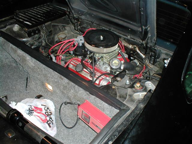

When switching to carb the ECM will be disconnected. You can trim the harness and remove wires to sensors no longer used and the "check engine" light bulb is removed from the dash. You need to add 1 wire for the electronic choke.
If you want to go tp TBI, Holley makes a 670cfm 2-bbl pro-jection TBI system. It is completely stand alone and easily adjustable. You would need the 2-bbl riser from Edelbrock. The TBI set-up can also be made to be Emission testing friendly where the carb set-up will not pass.
With a 4-bbl it will look like this: (Note: I used a 3" air filter instead of the original 1" air filter to raise the air cleaner into the decklid scoop.)

Oreif; what do you think the total cost is for doing the carb setup, what with the intake, adapter, new carb, linkage (if needed), and maybe hood mods? Having used 4bbls on my Cuda etc, I'm partial to fuel injection and was wonding what the cost dif betwenn doing our $600 intake/chip and carb really is? I suspect that it's not as big a dif as it may appear. To me, $200-250 would fall into that catagory especially when you consider how much less complecated the install would be. And I do know that to some folks that extra $200 is lot of money. BTW: your setup looks great and I'm sure you have it working great too. Before I decided to build my own intake, I almost went the carb route too.

Originally posted by I wear pants:
Orief do you know of any other scoops that will allow you to use the larger air filter? I don't have the resources to fiberglass one in.
The bolt-on version of the mustang scoop works as well.

Oreif
16460 posts
Member since Jan 2000
Buying everythnig brand new costs about $650. Buying used (ebay and private parties) the entire set-up would run about $300 or less.
I know a few who bought parts thru Ebay and off of S-10 forums and spent about $150.
The set-up pictured above is now in another PFF members car. I now have a carb'd V-8.
[This message has been edited by Oreif (edited 07-06-2005).]

I have also done the carbed V6 (WIth MUCH help from Oreif, thanks again).
The car honestly pulls MUCH better now with the carb than it did with the FI. There was something wacky going on with the FI system, and we couldn't get it sorted out. It could have been a bad/leaking injector, bad sensor, etc, I'm not sure. The car used to have an iradic idle, and used to flatten out on the top end. Now the car starts smoothly, idles rock solid, and pulls very strong. The mpg in the city went down a hair but the highway mpg isn't bad if you keep your foot out of it.
Hey thats looking pretty good. I noticed you have an msd ignition in there too, any other mods?
Have any of you guys that have done the conversion to carberation upgraded your camshafts to go with the higher performance carb/intake? If so what kind of results have you gotten? Thanks again,
Matt
I used a cam that was about the same as the Crane H272 cam. Engine was dyno'd at 223hp/239 torque.
As a reference my engine had:
Ported/polished/shaved heads (bumped compression up from 9.0:1 to 9.4:1)
5-angle valve job
Comp Cams Roller tipped 1.52 rockers and heavy duty pushrods
Edelbrock cam and performance lifters (custom grind but very close to the Crane H272 cam)
Coyles double roller timing chain
Crane HI-6R ignition and coil (Like the MSD)
Hi-vol GM Performance Parts oil pump
Fiero Store Sprint exhaust manifolds/ Borla Exhaust.
Edelbrock intake with Holley 390 cfm 4-bbl carb
The last time it was chassis dyno'd and fine tuned I had 193hp to the wheels which was about 228hp at the flywheel.
86 SE with TH-125 trans (with street/strip torque converter and shift kit) car ran a best time of 14.2 in the 1/4 mile. Another member had a nearly identical set-up but with a 4-spd manual and he was running about 13.7 in the 1/4 mile.
[This message has been edited by Oreif (edited 07-07-2005).]
Do you know if the indy pace car style scoop will work?
Only if you get the race car scoop. The carb does not sit in the center of the engine compartment.
The race car indy scoop has a base that extends towards the passenger side of the decklid. The regular indy scoop does not and is designed to sit in the middle.
If you look at the pic you'll see the scoop I now have ( I did have an indy scoop on the car originally.) is offset to the right side of the decklid.
