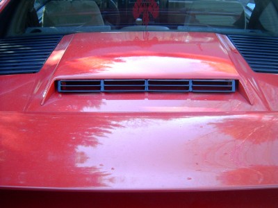

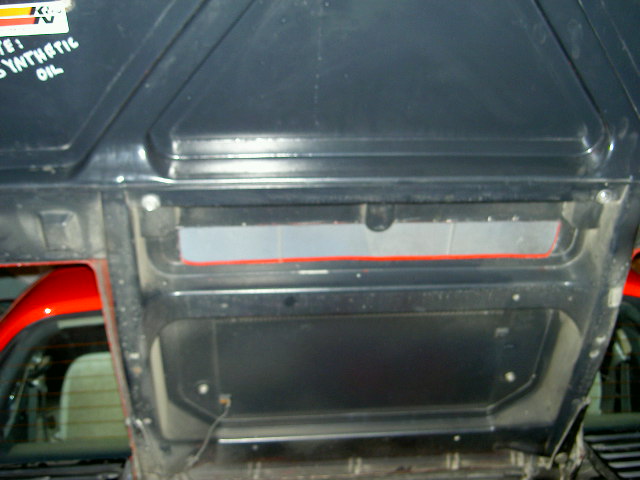

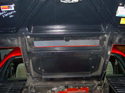

Heres some pictures. You don't need a very wide hole. no need to cut through the support brace
And one from above
Hope this helps ya!

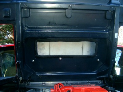

Report this Post07-04-2005 11:53 AM Click Here to See the Profile for GokartSend a Private Message to GokartDirect Link to This Post
I wouldn't cut the support brace either! My hole is about the same size. You can neaten it up nicely after by going around it with some weatherstrip. Having a small ridge around the hole will also aid in mad amounts of water entering the engine area when your hosing it down at the car wash
I made a custom grill for the front of it too.
