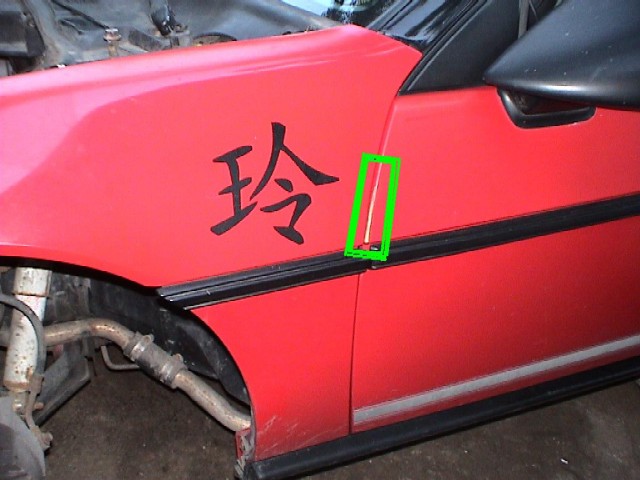

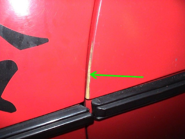

My fender and door have been rubbing for a very long time.
It would happen every summer and go away in the winter.
I would have to open my door about 2 inches, close it slightly and then reopen it.
And it was rubbing the paint off of my door.
It finally got so bad one day that it cracked my fender.

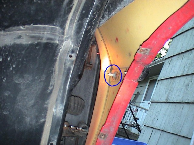

But as I was running some plumbing for my N20 purge solenoid and had the inner fender off I saw part of the molding clip sticking through the inside of the fender and had an idea.
so I took some measurements from the frame to the inside of the fender.

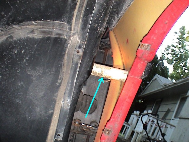

Hacked off a piece of PVC pipe about 1/4 inch longer.
Set it over the post of the molding clip and “popped” it in to place.
so to do this you need to remove the wheel.
The inner fender which is just some clips and 7mm bolts.
A junk piece of PVC pipe and a hack saw.

I used a razer-blade, and removed a teeny strip of the doorskin. I was surprised at just how easy it was to cut off...
But as other have said, I think you can slide some of the panels forward/back a bit...
