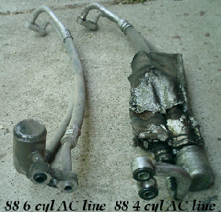

The easiest way to go is to just use the TDC compressor with the 87-88 Fiero 4 cyl AC lines/manifold. The V6 Formula AC lines will interfere with the TDC oil filter/oil cooler setup as seen in this photo of the 2
Then you will run a high side pressure sensor off the high side port up front in the Fieros spare tire compartment.
