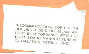

Originally posted by Fiero2m41:
my harness has started to melt because that stuff is gone on my car to. I just put some metal tape that is used on heat ducts on it and its been doing the job so far...
You are a braver man than I am. I have about 300 yards of that 2" aluminum Fasson "Fastape" and considered using it till I realized it's properties. It was designed for only one thing-heating/AC ductwork. For our Fiero uses, it has limitations and will (may) make things worse than no wrap at all.
1. Virtually no insulation value. You want either some air space or an insulating material between the reflective face and the wires/hoses/cables. I believe #2 explains it better.
2. Altho it may reflect some radiant heat, it is aluminum, therefore a great conductor of other types of heat -right into whatever you cover it with. Since the wire loom is covered, that heat will stay there with no way to escape as long as more heat is being transferred to it.
3. It is a true metallic, and an electrical conductor. Not the best thing to be covering wires with. I certainly wouldn't expect good results wrapping plug wires with it--not that you did.
Now, if you were to 1st wrap some insulation around your harness or shift cables, with some type of 'R' value, you probably would be ok.
just my 2 cents worth of worthless opinion, but I'd hate to hear your car burned up.
In the 2nd pic, you can see the underside with the right upper corner of the paper backer peeled back. Nothing there but a thin film of adhesive.
