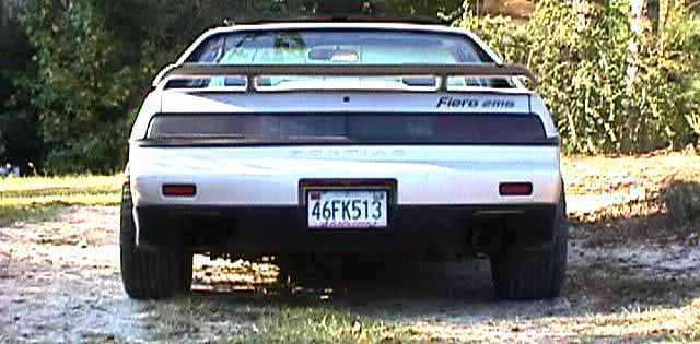

Blacktree
Posts: 20770
From: Central Florida
Total ratings: 350
Report this Post05-28-2005 10:54 PM Click Here to See the Profile for BlacktreeClick Here to visit Blacktree's HomePageSend a Private Message to BlacktreeDirect Link to This Post
It depends on what type of rear suspension you have. I was able to fit 245's on the back of my '87 SE. But the sidewalls were dangerously close to the spring perches on the struts. I think with anything wider than 235mm (just to be safe), you should use adjustable coilovers.

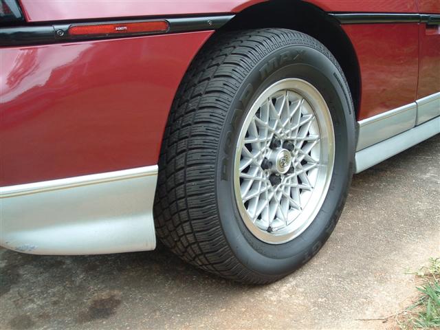

Wolfhound
Posts: 5317
From: Opelika , Alabama, USA
Total ratings: 113
Report this Post05-29-2005 12:10 PM Click Here to See the Profile for WolfhoundClick Here to visit Wolfhound's HomePageSend a Private Message to WolfhoundDirect Link to This Post
265/50R15
