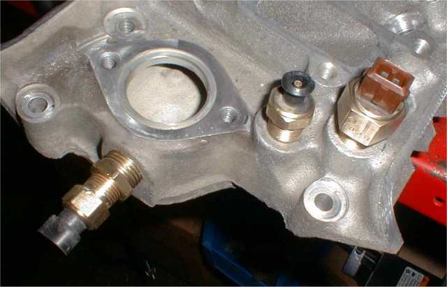

Simple "Q" ....What does the ECM coolant temperature sensor do?
I was reading another post and I saw a picture of JazzMan's, in it he shows a ECM coolant temp. sensor
tell me about it please
Ok, in this picture, left to right, are the ECM coolant temperature sensor, the radiator fan switch, and the cold start injector switch:

It gives the ECM info on the tempature of the engine (the ECM has no knowlege of the sensor on the head that goes to the guage) The ECM uses the temp info for fuel management.

So......my temp guage in my car could be reading, say 200 degrees, and the ECM temp sensor could be reading a different temp?? say 175 degrees.......??
The reason I'm asking is my guage in my car does read around 200-210 but when I run Winaldl, it's only showing aroumd 175 degrees.

One of the sensors is bad, that's for sure, either that or the guage is inaccurate. The ECM doesn't see and doesn't care about the guage sensor, but if the ECM sensor is bad, reading low, it will cause the ECM to deliver more fuel than needed, especially when cold.
